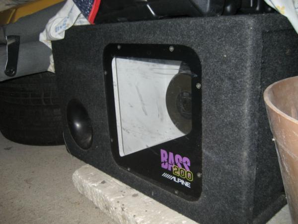

tak sem koukal na netu na obrazky :-D a je to ted v bandpassu s jednim natrubkem

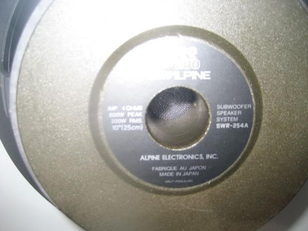

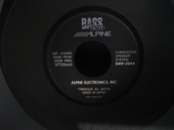

hm, tak asi tam zadny pouzitelny informace nejsou... vyfotil jsem to ale asi je to naprd
o 24.11.2007, 14:02 | hanzi
foto1
foto k příspěvku  od hanzi
o 24.11.2007, 14:03 | hanzi
foto2
foto3

neumim nemecky ale tady se o tom nejspis bavej:
a hodnoty co tam psali:
Power Handling Capacity ................. 200W RMS
Recommended Amplifier Output ............ Up to 200W RMS
Frequency Response ...................... FS-3.0kHz.
Sensitivity ............................. 88dB (1W/m)
Impedance ............................... 4ohms
DC Coil Resistance (Re) ................. 4.0 ohms
Free Air Resonance (Fs) ................. 30Hz.
Equivalent Suspension Stiffness (Vas) 2.22cu.ft.(63.0 liters)
Mechanical Q (Qms) ...................... 4.14
Electrical Q (Qes) ...................... 0.33
Total Q (Qts) ........................... .030
Excursion (X linear) .................... 4.1mm
Cone Area (Sd) .......................... 356sq.cm.
Magnet Material,Weight .................. 38oz.(1.08kg.)
Voice Coil Diameter ..................... 2.0 in.
Driver Physical Volume .................. 164.7 cu.in.(2.7 liters)
Mounting Depth (drop-in) ................ 4-16/16 in.(110 mm.)
Cutout Diameter (Front mount) ........... 9-1/8in (232 mm)
Driver Weight ........................... 3.8kg. (7lb. 8oz.)
tak jestli by stacilo tohle?
