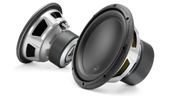

foto k příspěvku  od L.O.mmax
o 24.06.2006, 23:43 | L.O.mmax
prostě úžasnej reproduktor... :-)

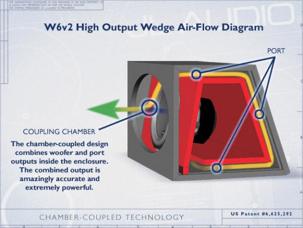

o 25.06.2006, 14:54 | L.O.mmax
JL Audio's patented (U.S. patent #6,625,292) High Output Enclosures are designed specifically
to work with JL Audio subwoofers to create a system that delivers the best of both worlds...
Excellent sound quality and awesome output!
• More output and better sound quality than traditional ported and bandpass designs
• Outstanding output regardless of placement within the vehicle
• Angled back design saves precious cargo space (Wedge models)
• Port wall integration / Internal bracing ensures structural integrity
nebo zkusit něco takového, ale přímo na 12W3v3 !
