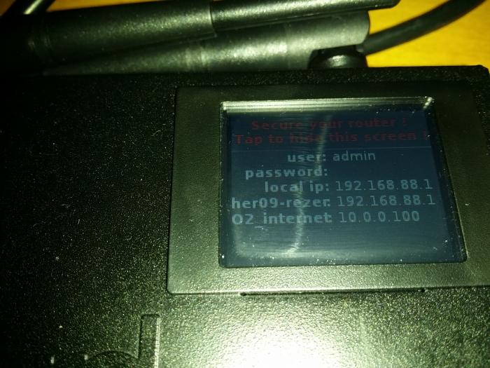

A zatim jeden dotaz, na display zarizeni mam souhrne informace o nastaveni IP portu - viz obrazek a nevim jak zmenit local IP. rad bych tam mel 192.168.1.1 (nebo to nemam resit?)
Vypis nastaveni IP adres:
[admin@MikroTik] > ip address print
Flags: X - disabled, I - invalid, D - dynamic
# ADDRESS NETWORK INTERFACE
0 192.168.88.1/24 192.168.88.0 ether09-rezerva
1 192.168.1.1/24 192.168.1.0 bridge-local
2 10.0.0.100/24 10.0.0.0 ether10-O2_internet
