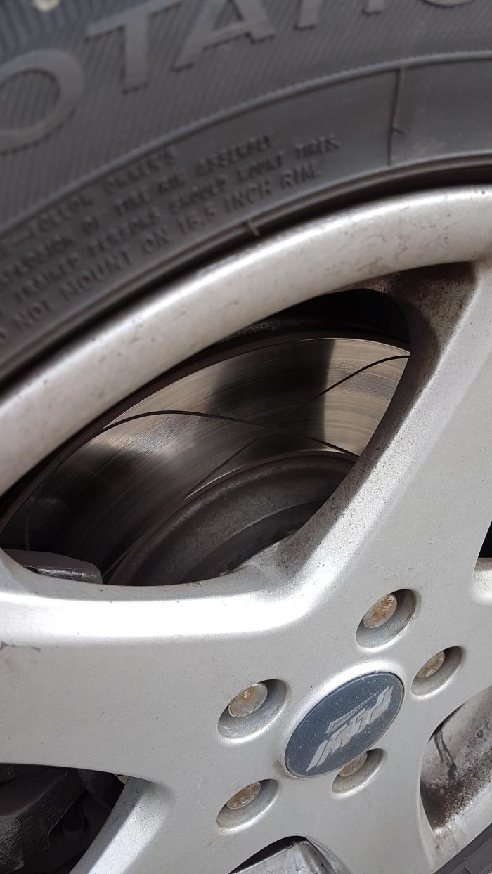

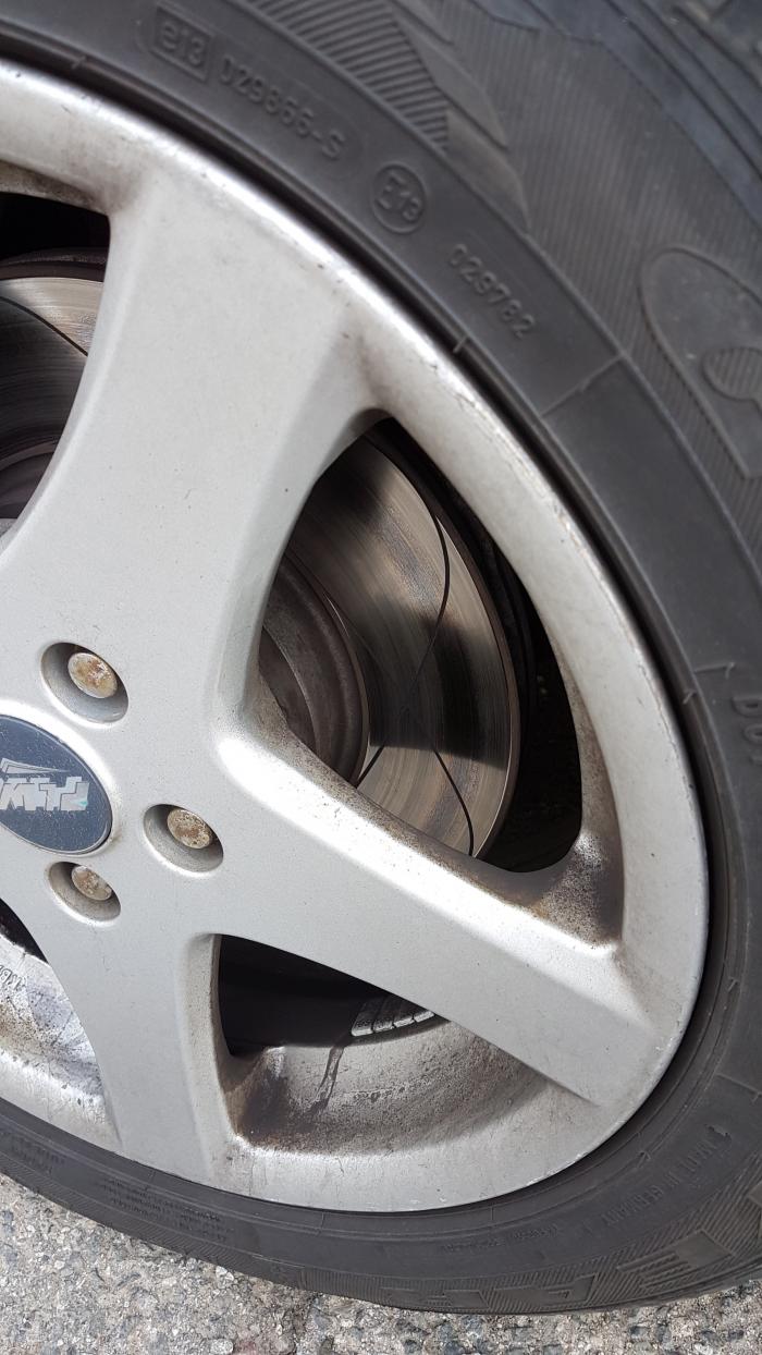

o 12.03.2017, 07:36 | dj.DEKL
Pratele, proc to dela ten prouzek na kotouci ? Co je spatne ? Desticky a brzdic chodi... oboje ATE
