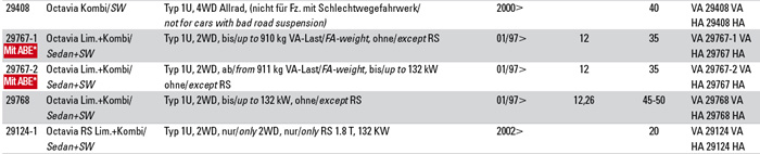

o 13.08.2008, 10:09 | tomarny
BadyS: To nevim co si googloval a jaky kraviny si kde vygoogloval .... taky mas kompletni nabidku pruzin H&R pro starou Koktu.
foto k příspěvku  od tomarny
o 13.08.2008, 10:13 | tomarny | Upraveno: 2008-08-13 10:14:13
a popis barev jednotlivejch sad ....
29408-1 Skoda Octavia Combi Typ 1U -color red, lowering [mm] 40
29767-1 Skoda OCTAVIA (1U), axle weight [kg] up to 910 kg front axle weight color black, lowering [mm] 35, year: ab: 01.1997
29767-2 Skoda OCTAVIA (1U), axle weight [kg] from 911 kg front axle weight color black, lowering [mm] 35, year: ab: 01.1997
29768-1 Skoda OCTAVIA (1U) up to 110kW, without RS, color black, lowering [mm] 50, year: ab: 01.1997
29124-1 Skoda Octavia RS Lim + stationwagon Typ 1U, only 1, 8l Turbo, only 2WD, color black, lowering [mm] 20, year: ab: 2002
