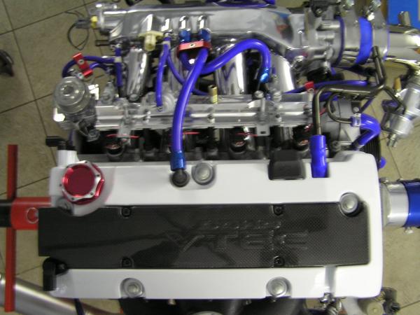

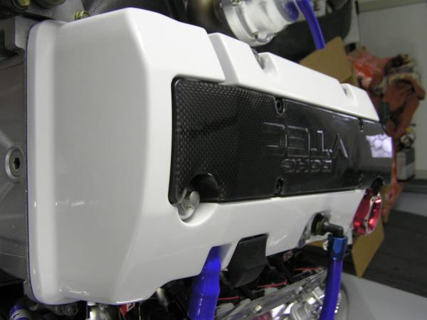

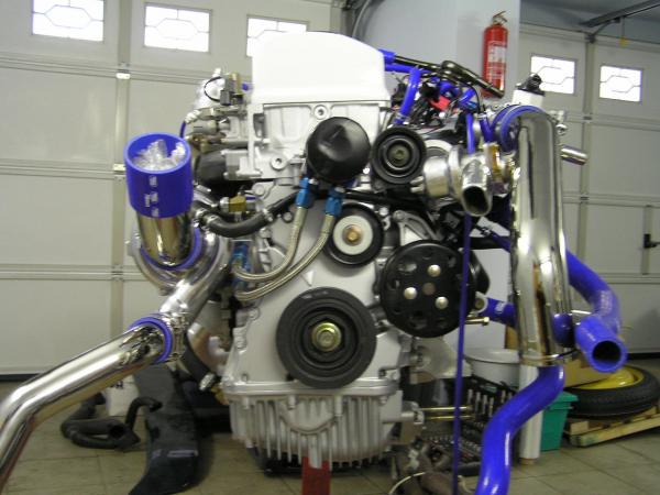

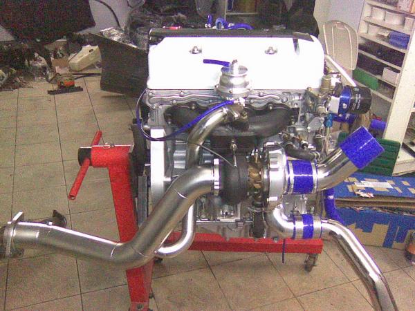

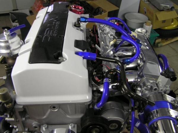

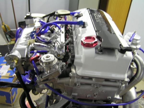

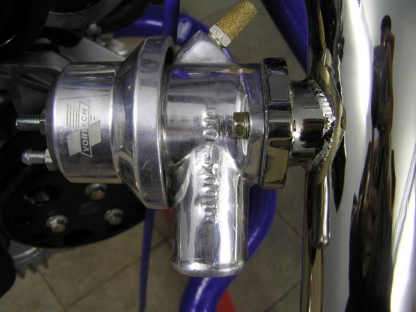

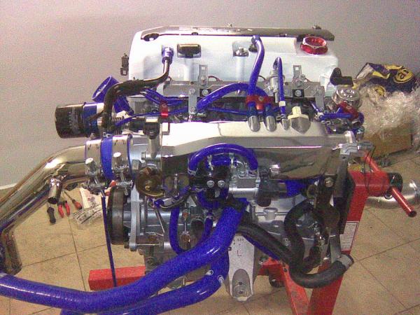

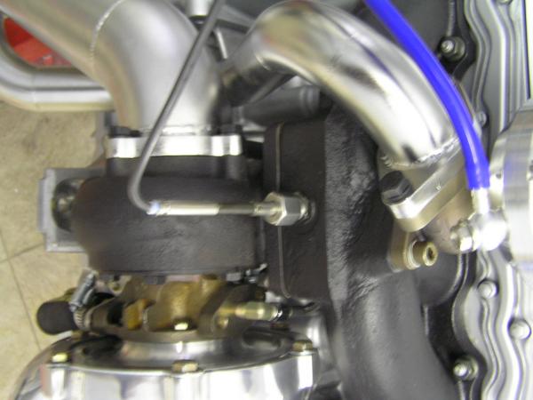

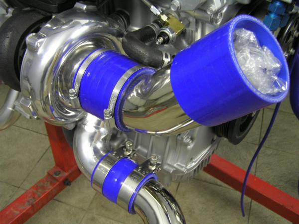

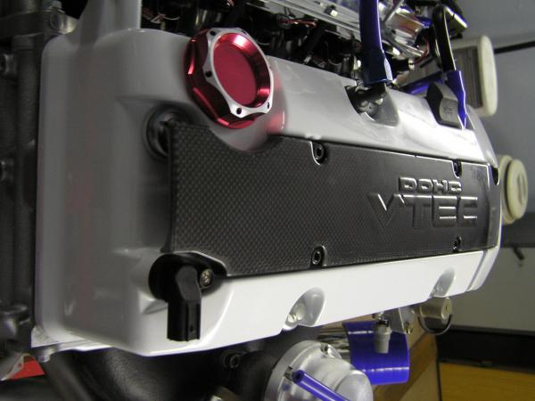

Tak na zadost par lidi sem hazim fotky motoru jak pokracuju, ca do mesice by melo byt hotove vse. Chybi par blbosti, ale ty by mely byt uz na ceste z US. Omlouvma se za fotky, ale s fotakem oc mam doma si mor nerozumim, svetlo nebylo v garazi taky moc idealni. Do leta snad pofrcim.
foto k příspěvku  od Rajdlos

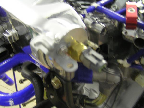

o 03.03.2008, 16:29 | Rajdlos

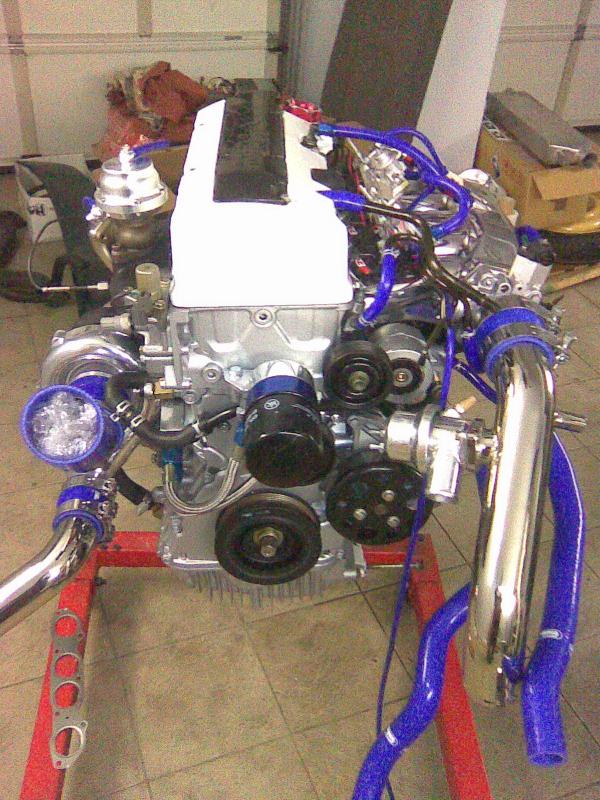

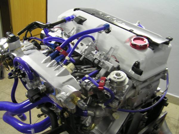

o 03.03.2008, 16:30 | Rajdlos

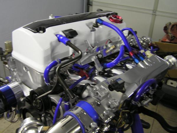

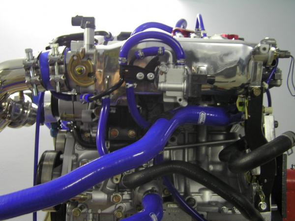

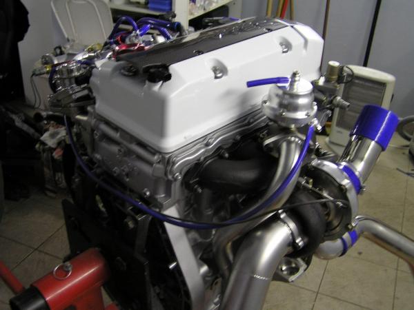

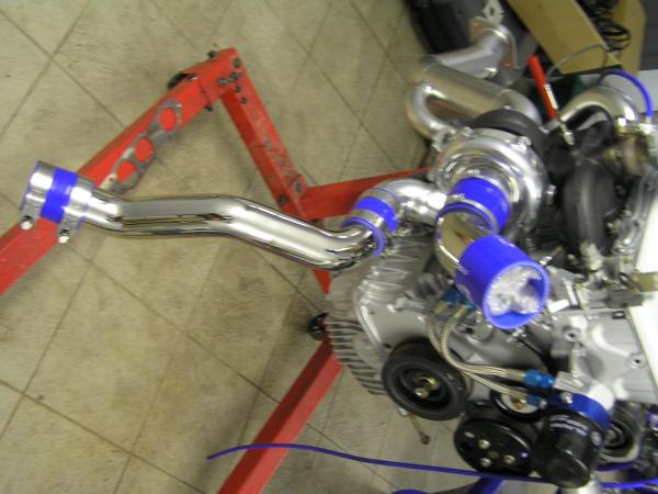

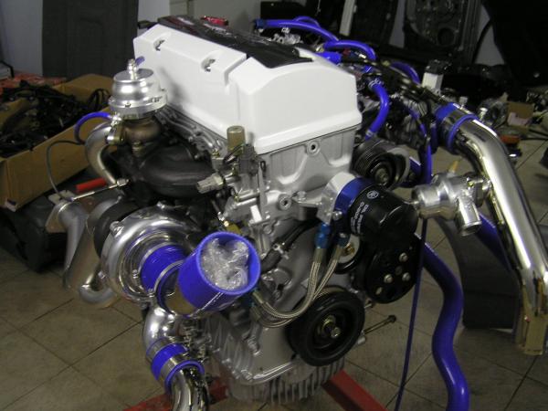

o 03.03.2008, 16:37 | Rajdlos

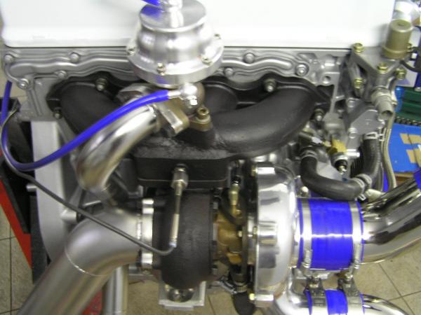

Tady jsou dily, ktere budou pouzity, motor je kompletne predelany, vevnitr zustala seriova jen klikovka a vacky a zdvihatka (to je vse nove). Blok je kompletne vybrouseny a nalakovany, jako vsechny casti, vsechny cidla na motoru jsou taky pro sichr nova. Ted uz jen sehnat nekoho kdo umi AEM EMS a kdo to naladi.
Prestavba se tahne ca uz dva roky jen pro info :o)
ENGINE & TRANSMISSION:
- 2.0 DOHC 16V VTEC I-4 F20C (177KW/240PS @ 8300rpm, 208Nm @ 7500rpm) – MY 2003
- 6-sp. manual trasmission – MY 2003
Block:
- AEBS T-sleeves engine work
- CP forged pistons 9:1 w/ rings
- CARRILLO forged rods
- ARP head studs
- ARP rod bolts
- ACL rods bearings
- ACL main bearings
- ACL thrust bearings
Head:
- FERREA competion plus stainless steel valves
- FERREA dual springs
- FERREA titanium retainers
- FERREA valve locators
- COMETIC head gasket
Boost:
- REV HARD turbo kit stage 2
- Turbo T3/T04E hybrid (60air)
- REV HARD cast iron manifold
- TIAL 35mm wastegate
- VORTECH blow off valve (BOV)
- Map bypass valve
Fuel & ignition:
- AEM EMS standalone 30-1052U w/ UEGO controller
- DENSO IRIDIUM spark plugs IK24 (1 step colder)
- RC 750cc saturated injectors w/ clips
- BDL fuel rail (titan)
- AEM fuel pressure regulator
- VORTECH fuel management unit (FMU)
- NOLOGY spark plug hot wires
- WALBRO high volume intank fuel pump 255lh
- B&M fuel pressure gauge
- Fuel rail adapter
- Steel fuel line
Cooling:
- KOYO aluminium radiator
- SEIBON SC carbon radiator plate
- SPOON thermostat (low temp)
- MUGEN fan switch (low temp)
- SPOON radiator cap 1.3bar
- PIPERCROSS air filter 3”
- Intake extreme gasket (block off the EGR)
- SPEARCO intercooler 27”x6.5”x3”
- Chromed IC 2,25” aluminized mandrel bent piping
- SAMCO intercooler silicone hose (blue)
- SAMCO radiator silicone hose (blue)
- SAMCO vacuum hose (blue)
- Big stainless clamps
Clutch:
- CENTERFORCE dual fiction clutch kit
- ACT PROLITE moly stell flywheel
- CUSCO RS 1.5way limited slip differential (LSD)
- Final gear ratio 4.44
- Stainless steel clutch line
Others:
- TEIN hood damper conversion
- Polished intake manifold
- White valve cover
- Carbon spark plug cover
- CUSCO oil catch can
- JS racing magnetic bolt
- Relocation oil kit
- Steel oil line
- Oil filter sandwich
- SPOON oil cap
- SPOON reservoir tank cover
- R1 WURKS high performance alternator pulley
- Krank vents
- OMNI POWER 4 bar MAP sensor
- AEM EGT sensor kit 30-2050
- AEM air inlet temperature kit 30-2010
- AEM boost gauge
- AEM EGT
EXHAUST:
- Custom downpipe 3” stainless steel (polished)
- ULTIMATE RACING 3” high-flow stainless steel catalytic converter
- ULTIMATE RACING 3” stainless steel exhaust catback w/ AP2 OEM tips (polished)
- MAFIA 3” test pipe (polished)
- THERMOTEC exhaust header wrap
SUSPENSION:
- CUSCO front strut bar
- KYOKUGEN lug nuts
BRAKES:
- BREMBO BIG BRAKE KIT front brake 4-pistons (red calipers)
- BREMBO front drilled rotors 12,9” (328x28mm)
- GOODRIDGE front and rear steel brakelines
- TRINET rear drilled rotors
- COMPTECH rear relocation kit with drilled rotors
- EBC green stuff rear brake pads

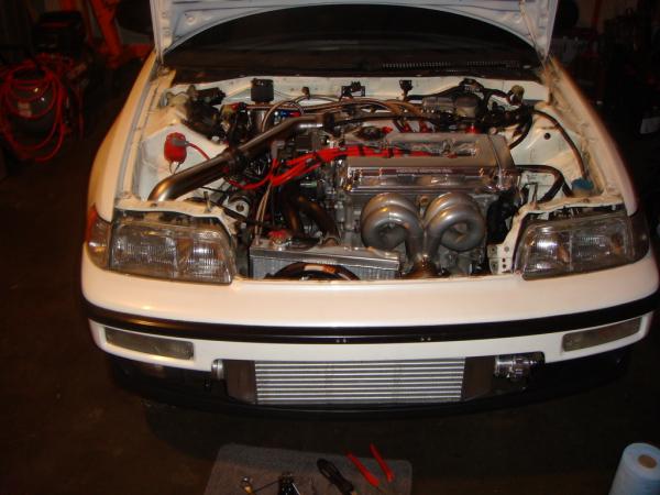

o 03.03.2008, 21:28 | Karlos
foto k příspěvku  od Karlos

Rajdlos: Nádherná práce, přesně moje krevní skupina. Už se těším na celek a doufám že to uvidím někde naživo!
o 04.03.2008, 17:50 | ebeerman
Hondy mají prostě potenciál no:) CRX 400hp :)
foto k příspěvku  od ebeerman
o 04.03.2008, 19:38 | Petura
paráda, můžu si k tobě dát svoje auto? :o)
o 06.03.2008, 09:40 | venito
no jako motor mazec, je fajn kdyz to jede a zaroven i vypada:o)
pak hod grafy z brzdy.....
o 06.03.2008, 14:48 | Rajdlos
graf z brzdy samo hodim pozdejs :o)
o 06.03.2008, 14:57 | PepeCV
krása to je úplně škoda dávat do auta ,-))
o 06.03.2008, 20:30 | Borik2
teda, to je mazec..a teprve bude!
o 07.03.2008, 20:15 | vaz2101
nadhera,ja bych si ho dal do obyvaku
o 07.03.2008, 21:55 | venito
ted sem si vsiml presunuti olejoveho filtru, krasna vychytavka:) ikdyz to motor jeste vic prehadickuje:)
