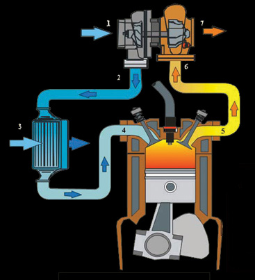

je to těžký uvěřit, ale asi nemáš pravdu, já tomu původně taky nechtěl věřit, ale koukni na todle o kinetický enerkii vejfukovejch plynů tam není ani slovo
The components that make up a typical turbocharger system are:
The air filter (not shown) through which ambient air passes before entering the compressor (1)
The air is then compressed which raises the air’s density (mass / unit volume) (2)
Many turbocharged engines have a charge air cooler (aka intercooler) (3) that cools the compressed air to further increase its density and to increase resistance to detonation
After passing through the intake manifold (4), the air enters the engine’s cylinders, which contain a fixed volume. Since the air is at elevated density, each cylinder can draw in an increased mass flow rate of air. Higher air mass flow rate allows a higher fuel flow rate (with similar air/fuel ratio). Combusting more fuel results in more power being produced for a given size or displacement
After the fuel is burned in the cylinder it is exhausted during the cylinder’s exhaust stroke in to the exhaust manifold (5)
The high temperature gas then continues on to the turbine (6). The turbine creates backpressure on the engine which means engine exhaust pressure is higher than atmospheric pressure
A pressure and temperature drop occurs (expansion) across the turbine (7), which harnesses the exhaust gas’ energy to provide the power necessary to drive the compressor

jenže si přečti tu větu před tím, na turbínovym kole docházi k expanzi a tím se ta urbína roztočí, stejně jako se pohne píst
alespoň takle to chápu já
než mi to bylo vysvětleno :-) tak jsem si taky myslel, že turbo rozáčí výfukový plyny, stejně jako voda mlýnský kolo

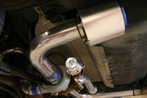

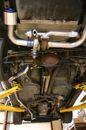

ještě by mě zjímalo jak se chová turbo co není umístěno u motoru ...
foto k příspěvku  od MarauderZ28
o 17.02.2007, 11:03 | MarauderZ28
o 17.02.2007, 11:05 | tappaja
No podle me je umisteni u motoru z duvodu co nejkratsich trubek, aby turbo nemelo dlouhou odezvu a diru, nedovedu si predstavit, co musi to turbo nafoukat vzduchu do tech dlouhejch trubek na pozadovanej tlak.
o 17.02.2007, 11:08 | MarauderZ28
takže tam bude jako velká turbodíra ?
o 17.02.2007, 11:28 | Scream
by me zajímalo, co je tole za debilní počin a taky jakym zpusobem ma vyresenej odvod mazaní zpatka do vany. na konci toho vyfuku musí mít ty spaliny hroznou energii....
o 17.02.2007, 13:21 | blázen
než to dostane vzduch do válců tak stihneš vykouřit cigaretu .-))
o 17.02.2007, 13:33 | MarauderZ28
mno a přitom se to prodává jako ofiko celej kit ná zástavdu a dělaj to dlouho tak to asi nějak fungovat bude ...
o 17.02.2007, 13:36 | Scream
to ze se to prodava a je to na US ajúto jeste neznamena, ze je to neco dobryho. na konci vejfuku budou plyny studeny a pomaly nehlede na LAG
o 17.02.2007, 14:38 | MarauderZ28
já neříkám, že to je dobrý jen mě zajímá jak to funguje resp jak se to chová oproti autu co je má na svodech ...
o 17.02.2007, 15:07 | Scream
ty plyny se po ceste hrozne schladí a tim ztrací spoustu energie, aj si myslim, že efektivita je snížená o desítky procent.
o 17.02.2007, 17:38 | RedBaron
No tohle je fakt dobrej setup, teď už jen zbejvá aby amíci vymysleli auto, který bude mít motor vzadu a pohon přes kardan na přední kola :o)
o 17.02.2007, 18:07 | MarauderZ28
ještě existoval prototyp - tubína byla součástí zadní nápravy jako diferáku a to turbo přez nějakou převodovku či co pomáhalo hejbat poloosama, bylo to v 60 letech ...
o 17.02.2007, 18:33 | Nevřis
RedBaron..lol :)
o 17.02.2007, 18:43 | MarauderZ28
nicméně vypadá to, že to funguje docela schopně ...

jinak je snaha udrzet plyny co nejteplejsi (svody pokud mozna kratke, z tenkeho tepelne nevodiveho materialu-okolni vzduch=izolant), proto se bali nebo aplikuji tepelne izolacni nastriky (vetsinou ZrO2)...
o 19.02.2007, 22:12 | MarauderZ28
mno a jak pak může fungovat to turbo na konci kde je rozdíl teplot jen 150 stupňů oproti rozdílu 950 stupňů u motoru ???
o 20.02.2007, 10:39 | .mycTD
Mar: vyfukove plyny tam proudi furt, takze turbo se tocit bude, ale snizujes tim ucinnost

marauder: tak si k tomu taky neco pripisu:) to turbo az vzadu fakt nechapu....ikdyz jestli neni na ceste nejakej tlumic tak by se plyny nemeli nejak vyrazne zpomalit..... akorat bude turbo pomaleji reagovat prave o tu vzdalenost kterou musi urazit.....
jinak turbo roztaci kineticka energie vyfukovych plynu.... takze jejich teplota na to ma vliv takovej, ze kdyz klesne zmensi se jejich objem a tim zpomaly...ale nebude to nijak zvlastni vliv.....
kompresor vs turbo..... turbo je relativne mala a na vyrobu jednoducha vec.... toci se rychle tak nemusi bejt nejak extra utesneny a vyrobne nejslozitejsi budou loziska ...... dalsi vyhoda je ze pro pohon pouziva energii vyfukovych plynu ktera by jinak prisla vnivec....vyssi ucinnost nez atm. motor....nedokaze zadnej extra velkej tlak...muselo by byt vicestupnove......
kompresor naopak dokaze nafoukat libovolnej tlak, ale je vyrobne slozitejsi - tudiz drazsi, rozmerove vetsi /tezsi a je hnanej od kliky...tzn 'zere' vykon motoru....ucinnost je mensi nez atm.motoru......jo a dava uz v malejch otackach......
pro bezny stroje staci tlak co nafouka turbo a pak je vyhodnbejsi kvuli vyhodam ktery jsem zminil......
no a u motoru kde je fuk kolik to zere a kolik to bude stat, po jizde se stejne da vse nove (dragstery atd) tak to plnej nakym velkym tlakem a pouzijou kompresor......
u mercedesu je to asi vec tradice a prestize.... neni tam teda reakcni doba turba...ale to uz umej dnesni elektronicky udelatka uregulovat..... proc to neudelat jednodusse kdyz to jde slozite
