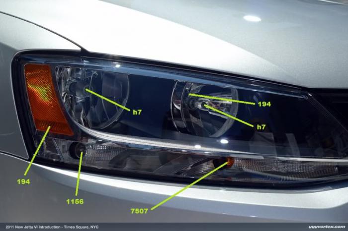

Resim aktualne otazku DRL (denni sviceni) na VW JETTA MK6. Original je halogenova BA15S (1156, P21W) a chci to nahradit LED moduly.
Jake mate zkusenosti s aktualni nabidkou LED autozarovek?

Pro info, jak je reseno DRL na VW JETTA MK6 (2011). Na foto oznaceno 1156.

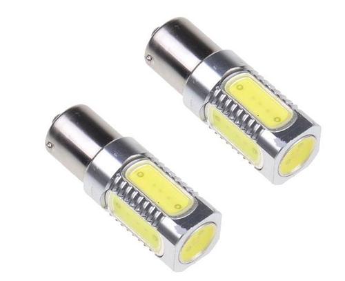

Jednoznacne muzu doporucit tyto LED moduly:
Description:
100% new and high quality
Bright white LED light, and easy to install and remove.
Gives the car behind an extra warning when you're about to stopping, backup or turning to protect passengers and cars from unnecessary bumps also provide a beautiful look of all vehicle.
Ideal replacement LED bulbs for your Turn Signal Light, Corner Light, Stop Light, Parking Light, Tail Light and Backup Lights, etc.
Specification:
Model:LD-1156C-7.5W
Power:7.5W
Light color:white
life span: more than 20,000 hours
Beam Angle:320 degree

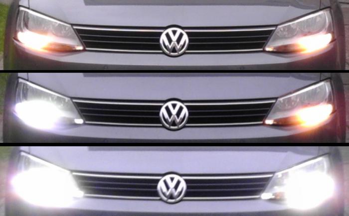

Pro info, jak to vypada na aute...
Upozorneni: mezi prvnim a poslednim snimkem je cca 50 min. casovy rozdil. Takze uz se setmelo a proto se zda, ze to sviti vice, nez puvodni halogenove zarovky.
Intenzita je totozna, mozna jen nepatrne jsou LED silnejsi, coz neni na skodu diky teplote svetla a pouziti jako denni sviceni.

Co je jeste podstatne, auto (palubovka, diagnostika) nehlasi zadnou chybu. ;)
